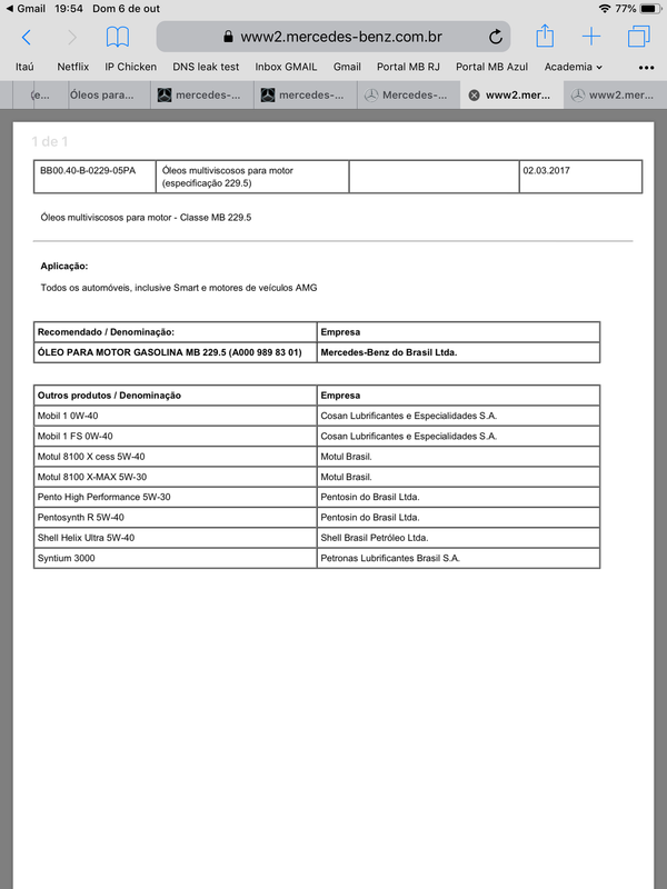

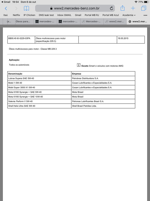

Mensagem por Marujo_BSB Dom 6 Out 2019 - 19:56
Eduardo, não tem dúvida. Use qualquer óleo das listas 229.3 ou 229.5
Seguem os links da mercedes Brasil
https://www2.mercedes-benz.com.br/passengercars/being-an-owner/services/service-type/guia-lubrificante-pdf/_jcr_content/par/downloadbox/downloadcolumn1/download_1141043887.attachment.oleo-motor-BB00.40-B-0229-05PA.pdf?owda=misc
https://www2.mercedes-benz.com.br/passengercars/being-an-owner/services/service-type/guia-lubrificante-pdf/_jcr_content/par/downloadbox/downloadcolumn2/download.attachment.oleo-motor-BB00.40-B-0229-03PA.pdf?owda=misc
